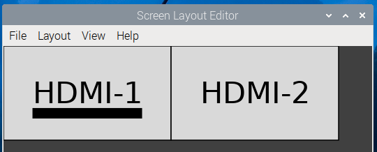

Using electronOptions
The most common use for electronOptions is a dual monitor setup on a Raspberry Pi 4 or greater. To do so, you can launch a second MagicMirror and use electronOptions to move it over to the next monitor. For example:
You have two 1920x1080 monitors set up in the Pi as sitting next to each other: Screen-Layout-Editor
To move the pi to the second monitor, use this:
js
const config = {
	electronOptions: { x: 1920 },

Two Screens
A user has two monitors running on a Pi4B. User wants to show cameras on one monitor, and wants to show informational panels on the other. Monitors are set up as above.
User would have to set up two config files, and two starting scripts to do so. User would use method of choice to launch starting scripts (e.g.: PM2).
Starting Script 1 (mm.sh):
bash
cd ~/MagicMirror
node --run start
Starting Script 2 (mm2.sh):
bash
cd ~/MagicMirror
export MM_CONFIG_FILE=config/config2.js
node --run start
